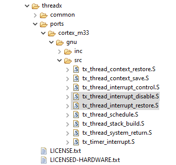

It seems the X-CUBE-AZRTOS-F7 1.1.0 is based on ThreadX 6.1.7. But after select 'Enable BASEPRI support', it missed several files which exist in the official 6.1.7 release, they are:
tx_thread_interrupt_disable.S and _tx_thread_interrupt_restore.S.
Thanks.

Hello @diverger ,
I have created a project with STM32F722ICK6 and I have installed and enabled X-CUBE-AZRTOS-F7.
tx_thread_interrupt_disable.S and _tx_thread_interrupt_restore.S are well generated.
Thanks.
Mahmoud
It's weird that your MCU is a F7 based on cortex-m7, but it shows 'cortex-m33' in the picture. In my case, I use STM32F769.
Please check it.
Thanks.
