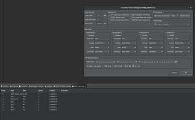

In the example USBPD_SNK it tell you to view the traces like this.
Run CubeMx Monitor and open trace tools
I'm guessing this is something inside of STM32Cube ide.  Not STM32CubeMonitoring app
https://www.st.com/en/development-tools/stm32cubemonitor.html
So i started the trace's like i normally would in STM32CubeIde but it doesn't seem to show anything in the trace output when i run the application.
They say to use STM32CubeMonitor but when i connect both ends to my computer i don't see any com's to select.
Currently i'm not entirely sure how to enable the traces, so any help would be greatly appreciate.

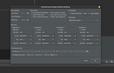

Problem
* I needed the SWV Trace Log window
* PC Sampling enabled

Can you take a look at this tutorial STM32CubeIDE - SWV trace
It might be helpful.
