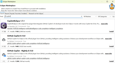

Running ST Cube IDE 1.19 on Windows 11, co-pilot autocompletions seem to be causing an issue. I see the suggestion, then a dialog pops up saying the following:
An internal error occurred during: "Generating completion...".
Invalid thread access
I look at the error log as I see the following:
Failed to parse wmic output
Exception Stack Trace:
org.xml.sax.SAXParseException; lineNumber: 1; columnNumber: 1; Premature end of file.
at java.xml/com.sun.org.apache.xerces.internal.parsers.DOMParser.parse(DOMParser.java:262)
at java.xml/com.sun.org.apache.xerces.internal.jaxp.DocumentBuilderImpl.parse(DocumentBuilderImpl.java:342)
at com.st.stm32cube.ide.mpu.remote.serial.internal.SerialPortProviderWindows.run(SerialPortProviderWindows.java:127)
at java.base/java.util.TimerThread.mainLoop(Timer.java:566)
at java.base/java.util.TimerThread.run(Timer.java:516)

Just Copilot (I avoid nightly builds)
A new update to copilot has just come in. Completion seems to be working now.
