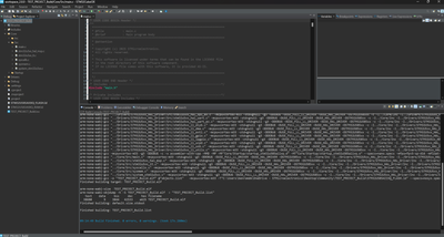

generated a new cubeIDE project with cubeMX, for my U585I-IOT02A board, the only things I changed are PC1 pin to high level and toolchain/ide to cubeIDE.
building gives me this error : /opt/stm32cubeide/plugins/com.st.stm32cube.ide.mcu.externaltools.gnu-tools-for-stm32.13.3.rel1.linux64_1.0.100.202509120712/tools/bin/../lib/gcc/arm-none-eabi/13.3.1/../../../../arm-none-eabi/bin/ld: read in flex scanner failed
no matter what I do or find on internet, I can't get it fixed...
I'm on arch linux and installed all stm32 softwares with aur and zip downloaded on the st site if needed.

I'm using standalone cubeMX version 6.16.0, and cubeIDE version 2.0.0. the complete console output is :
18:47:46 **** Incremental Build of configuration Debug for project test ****
make -j8 all
arm-none-eabi-gcc -o "test.elf" @"objects.list" -mcpu=cortex-m33 -T"/home/zach/Dev/test" --specs=nosys.specs -Wl,-Map="test.map" -Wl,--gc-sections -static --specs=nano.specs -mfpu=fpv5-sp-d16 -mfloat-abi=hard -mthumb -Wl,--start-group -lc -lm -Wl,--end-group
collect2: error: ld returned 1 exit status
make: *** [makefile:64: test.elf] Error 1
"make -j8 all" terminated with exit code 2. Build might be incomplete.
18:47:47 Build Failed. 2 errors, 0 warnings. (took 115ms)

The link script path looks strange: -T"/home/zach/Dev/test"  without the filename (a file that ends in .ld) ?
Are there any .ld files in /home/zach/Dev/test/ ?
