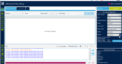

Failed to execute MI Command Error
Thenuk__a
Hy!
I'm new to STM32. I'm currently using STM32F103C8T6 board, and it give MI command error (image attached). I have tried using STM32 programmer as well to fix it. Still couldn't. How can i fix this?

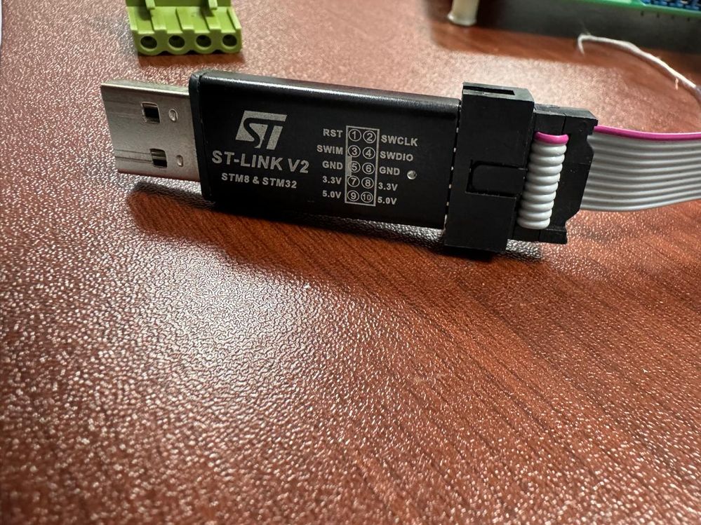

@Thenuk__a wrote:
I'm using ST-Link V2.
That's a clone - not a genuine ST product.
https://community.st.com/t5/stm32-mcus-products/blue-pill-stm32f1-board-gets-programmed-through-arduino-ide-but/m-p/668483/highlight/true#M242662
Check your connections very carefully - different clones have different pinouts!
The important part of the message is here:
So it's not seeing your STM32.
  • Is the target properly connected?
  • Is the target properly powered?

I have used only Arduino. The board i'm using is STM32F103C8T6. I'm using ST-Link V2.
Thanks. Changed the ST link and it worked
Excellent - please mark that as the solution
