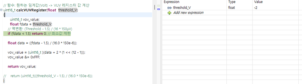

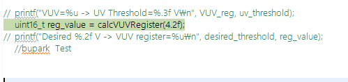

I'm trying to figure out why the value 4.2 is returned as -2 when passed as a function argument. Could you please also provide a solution? The MCU is an STM32F302VET.

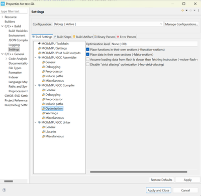

Is optimization turned off?
Ghofrane GSOURI
Hello @bupark007
As mentioned by @TDK  using high optimization levels can cause variables to be kept in CPU registers or even optimized away, making them difficult to inspect during debugging. To address this, try setting the optimization level to -O0 (no optimization) when debugging your code.
THX
Ghofrane
I'd probably instrument, and call test cases with terminal output to confirm the functionality.
I think there are reported issues with the debugger's memory/expression view.
Check you have pulled libraries with sscanf / printf support of floating point.
Inspect code generated by the compiler for consistency, double check the casting of the math at each stage.
Thank you for your answer. However, it is set in optimization mode.
I created a new project and confirmed that it would be output when I copied the above functions and debugged it. The current project keeps confirmed differently ~ I don't understand if STMCUBEIDE's own error ~

Does the if fdata < 1.5 line trigger? Maybe you're on a different statement.
Perhaps make a complete compile-able program that shows the problem.
The compiler is robust--unlikely to be any issues there.
Yes~ ifdata <1.5 line is executed and 0 is returned.
