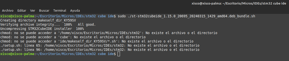

Cube IDE 1.15.0 installation fails when folder name contains spaces (Linux)
xisco
Senior
When the folder name of installer contains spaces, the installer tries to do a chmod to all words of the folder name.
Solved renaming the folder.

Hello @xisco and welcome to the community,
This behaviour is expected as the installation folder should not contain any spaces.
