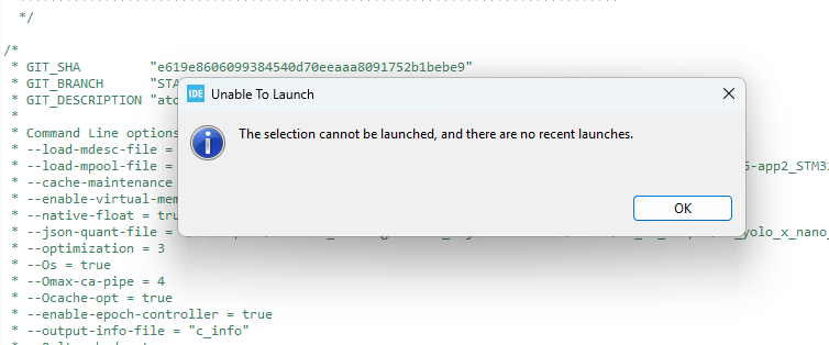

I'm trying to test and deploy this application on stm32N6-DK
https://github.com/STMicroelectronics/STM32N6-GettingStarted-ObjectDetection
Also follow this MOOC
https://www.youtube.com/watch?v=VV9f5e3nqM4&list=PLTJzs51NlEICI7ARAHOyUqMhTgJE0UFv0&index=8

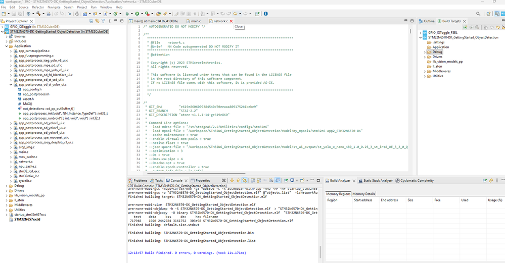

Loaded the project to stm32CubeIDE 1.19.0
Can buid the project
but impossible to configure or debug the application !!
or this error on debug view
If someone can help ...

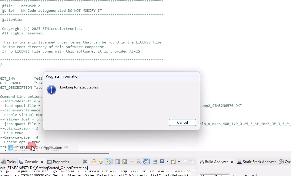

@Souhaib MAZHOUD thank you but i can't open debug configuration ... nothing happen (no popup windows open)
Thank you but we can't use cubeIDE to program and debug the N6 ??
Hello @mls
Did you set a breakpoint in your application before starting the debug session?
If yes, you should add a breakpoint while debugging as mentioned in the errata sheet Known issues.
"If the Application context contains any break point even if it is disabled, the debug session will not start.
Workaround:
Therefore, any break point needs to be added while debugging and after the execution of this instruction “retr = MapMemory();”.
This is why we set the breakpoint at JumpToApplication instead of main in the startup configuration."
