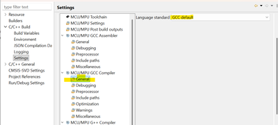

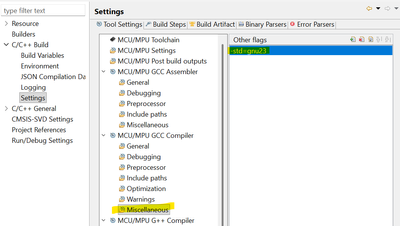

Starting from CubeIDE 2.1.0 version, you could use C23 by following these steps:
1- right click on the project > Properties > C/C++ Build > Settings > MCU/MPU GCC Compiler > Miscellaneous > Add a new flag "-std=gnu23"
2- click on "C/C++ Build > Settings > MCU/MPU GCC Compiler > General > select "GCC Default" in the "language standard" combo list 
3- Apply and close the Settings dialog
4- Clean and build the project

@mƎALLEm Hey thanks for the heads up. We tried that, but the IDE is still flagging lines with constexpr as syntax error (without further explanation of that error):
@TDK constexpr is also C23, and that until now is not supported by default. Since we don't use C++, the use of constexp is a little annoying in CubeIDE.
It's not that it is not compiling, that works without problems. It's simply the highlighting as a syntax error in the editor.
