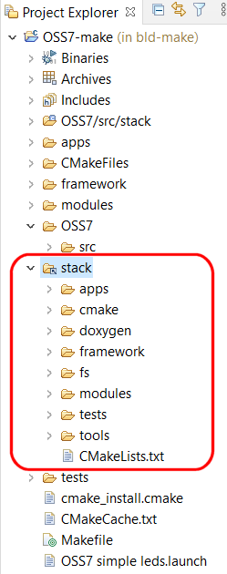

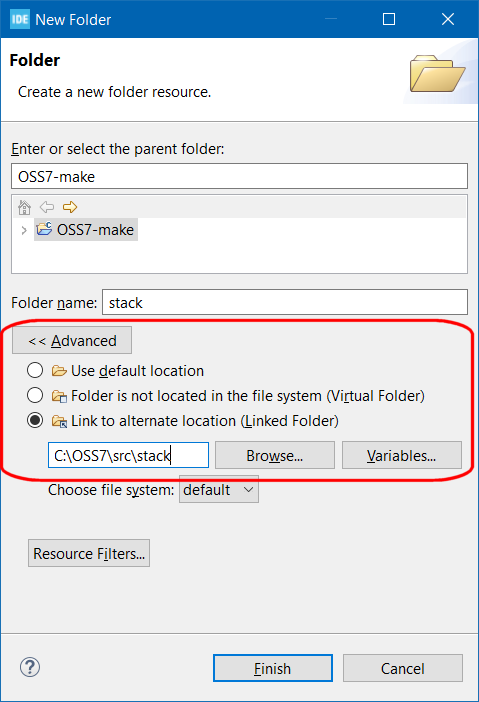

You can add a folder to the project as shown in this thread:
https://community.st.com/s/question/0D53W00000aqNBiSAM/cubeide-imported-eclipse-c-project-incorrectly-defines-cplusplus
This stupid forum doesn't allow linking to a specific post within a thread, so here's the detail:
Add a 'Folder' - not a 'Source Folder' - and used the 'Advanced' options to point to the source files location:
Which gives
