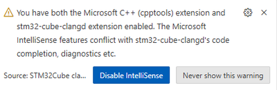

I recently upgraded my STM32 CubeIDE for VS Code extension to the new release with clang integration and project navigation. When getting the popup below I went ahead and disabled IntelliSense. However, I then lost my navigation capabilities such as "jump to" etc......
For now, I have IntelliSense re-enabled but would like to migrate to clang. Is there a step I am missing here?

The new Visual Studio code extension from ST uses clangd for language integration and as such is incompatible with the Microsoft C++ extension because the two will be fighting each other.
For the Visual Studio based extension, it makes use of CMake. CMake should also generate a database file called compile_commands.json. The command to generate this is specified in the CMakePresets.json around the top, you will see this
"cacheVariables": {
   "CMAKE_EXPORT_COMPILE_COMMANDS": "ON"
In order for CMake to populate the database, CMake must know about the files, and these are, in basic form, specified with the following CMake command: target_sources and include directories should be specified with: target_include_directories
clangd uses the database file to generate an internal representation of your source code so that it can provide the intellisense and navigation capabilities.
