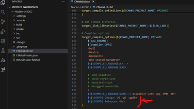

I create an empty project for Nucleo-L432KC with all default settings using STM32CubeIDE 3.6.4. on Win11.
Default settings are gcc toolchain and Debug preset.
Then, I switch to Release Preset (CMake: Select Configure Preset - as described in Development — STM32CubeIDE for Visual Studio Code Extensions Documentation 0.1.0 documentation).
After building in Build/Release, the compile commands are like
  "directory": "C:/tmp/test2/build/Release",
  "command": "C:\\ST\\cube\\gnu-tools-for-stm32\\13.3.1+st.9\\bin\\arm-none-eabi-gcc.exe -DRTE_DEVICE_STARTUP_STM32L4XX -IC:/tmp/test2/Inc -IC:/tmp/test2 -fdata-sections -ffunction-sections -Wl,--gc-sections -Wno-comment -O3 -DNDEBUG -std=gnu11 -mcpu=cortex-m4 -mfpu=fpv4-sp-d16 -mfloat-abi=hard -mlittle-endian -mthumb -Wall -Wextra -Wpedantic -Wno-unused-parameter -Os -o CMakeFiles\\test2.dir\\Src\\sysmem.c.obj -c C:\\tmp\\test2\\Src\\sysmem.c",
  "file": "C:\\tmp\\test2\\Src\\sysmem.c",
  "output": "CMakeFiles\\test2.dir\\Src\\sysmem.c.obj"
having two potentially conflicting optimization settings: -O3 ... -Os.
I would like to see more presets pre-defined like RelWithDebInfo and MinSizeRel and have a more direct way to configure all those flags.

Sounds weird to me. Empty project is promoting the following to me so I'm facing no issue while switching from Debug to Release:
You're asking to more presets ... myself I like to get only x2 ... more by default will lead to more complex and confusing first guess proposal. If I need more, I'm able to define it/them myself and at least they will fit my need better.

Yes, my CMakeLists.txt looks like yours, okay.
But check Release/compile_commands.json.
Where does the additional -O3 come from and how to change? grep doesn't find it in my project folder.
