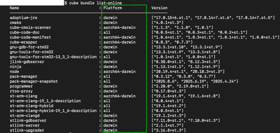

wlj
@Julien D I also noticed with the new 3.x.x plugin the tooling bundles are also not compiled for Apple Silicon. CMake throws a CPU error if rosetta is not installed. Is this also going to be fixed in the future?
Yes, no choices. Rosetta will be discontinued sooner or later.
The amount of native aarm64 bundles will grow during this transition period.
I'm wondering then what can we use for STM32 development on macOS apple silicon?
@47
Currently, Rosetta operates effectively. Only a few debug assets do not support the Arm® architecture. Toolchains and most utilities already support it.
The next update of the STM32CubeIDE for Visual Studio Code extensions, scheduled for release in a few weeks, will provide native support for the Arm® architecture on macOS for all related processes.
