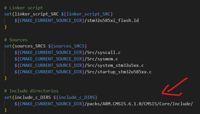

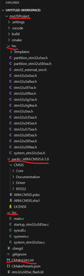

This is the first time we are receiving so much emphasis on the empty project feature, to be fair. As shared by @Cartu38 OpenDev , this feature is not new to the STM32Cube ecosystem, but I am very happy to see more traction and comments here!
I have already committed to forwarding your requests to product marketing. We always welcome feedback to serve you better whenever possible. Please could you argue how and why empty projects are convenient to you.
I may also share that we already have some work in progress on this.
May I take this opportunity to share what it looks like on my local (R&D internal) environment at this time to get your feedback? Please comment!
Disclaimer: I cannot commit to any date or .. having such public. However, the more votes and information we have ...
To be fair, one issue we ended up with today is the CMSIS.Core pack size. The empty project disk size is more than twice as large, thanks to ... It is hard to pick only a small part due to license concerns, so we have to keep it as original.
PS: Thanks @Kraal for bare metal naming proposal may make sense.

Empty project feature is supported since a while as part of STM32 ecosystem tools. STM32CubeIDE, already since years, is promoting the same empty flavor that VSCode proposal is doing.
@mark03 your suggestion is making sense but I guess hard to define proper level of such feature. Some may ask for a bit of HAL drivers, some for ... etc etc. But yes could be some extra options.
My bet is ST is shooting for a quite light solution for empty project, while if more is required STM32CUbeMX becomes your best friend.

The issue presented here is that the empty project is not including some key files, namely the device header files and the system_*.c file, which to me is a no-brainer. Those files will need to be copied to the project folder if you plan on doing anything useful. If the project generator can also pick these files, it is just one less manual task for the developer to do.
