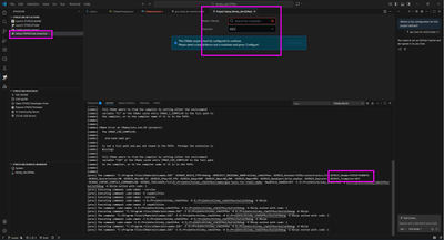

I have a small problem here. When I run a clean in git, the directories .vscode, .settings, and build are deleted. If the project needs to be rebuilt, the Setup STM32Cude project function has to be executed manually, and the board/device has to be specified manually again. This is very error-prone.
Is there a way to start this project setup from CMake or from CMakePresets.json?

@jwichmann why not adding these .settings & .vscode stuff to your source control resources ?
Myself I'm not hurted to consider any tool has the need for internal metadata ... they are part of the project kind of.
Looking at STM32Cube native proposal creating a so called empty project an .gitignore file is promoted ... it's crystal clear .settings has to be preserved
Because user-specific configurations are also stored in the .settings and .vscode directories. In my opinion, these have no place in a GIT repository.
For example, .settings/bundles.store.json stores whether st-link or j-link is used as the programmer. This is a matter of user preference, but not really relevant to the project. It should also not be relevant whether GCC or Clang is used as the compiler. This should be controlled by the CMake file itself, as well as compiler switches in the code. The paths of the current toolchain are stored in .vscode/settings.json.
I found out that if I keep the .settings/ide.store.json file, I can achieve the project setup with the desired default settings. Even if CMake configure is executed automatically three times, twice with compiler errors and the third time correctly.
