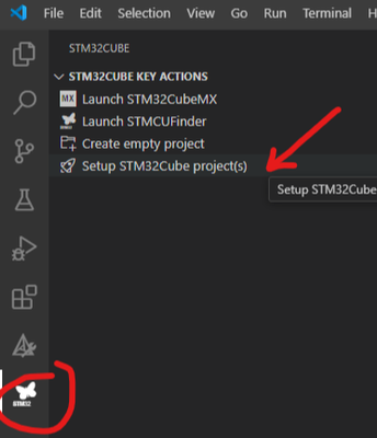

We have a large project that already defines several cmake presets, and we would like to reuse them in VS Code  STM32CubeIDE extensions.

@UStre.2  setup action not available ? .. is your CMake project building ?
Not having setup action available is sign the STM32 stuff is not detecting your project as a CMake project candidate.

@UStre.2
What happens if you just add your material to VSCode workspace ?
Have a try about adding extra STM32Cube contributions on top of:
A CMake project remains a CMake project and STM32Cube relies CMake tools extension ...
It's not selectable.
I have all configured.
my cmake project is building, but not importable.
