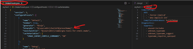

I have problem that most headers are not visible so a lot of dependent problems occured.
All files are present - the same project compoiled in STM32CubeIDE works.
There is note that "clang(pp_file_not_found)"
Tried to add paths in CMakeLists.txt but no luck.

@Jacek3 have you a .clangd file added by STM32Cube to your project root ?

Yes, I have .clangd file, but it was created rather by VSC, not STM32Cube.
My .clangd file:
CompileFlags:
 Add:
 - '-ferror-limit=0'
 - '-Wno-implicit-int'
 CompilationDatabase: build/release/build
Diagnostics:
 Suppress:
 - unused-includes
 - unknown_typename
 - unknown_typename_suggest
 - typename_requires_specqual
I have in Output window:
[driver] NOTE: You are configuring with preset release, but there are some overrides being applied from your VS Code settings.
and
can't open .map file
I suppose that the reason is that STM32Cube use .../Release or .../Debug while compile but VSC use .../buil/release or .../built/debug.
Do You know how can i change it in VSC?

I don't think the debug and release thing is the issue, I'm on Debug and have the same issue, and to change it just go to Command Palette: (Ctrl:Shift:P) and then type CMake: Select Configure Preset and select that
