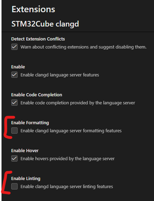

Although there are several ways to bypass the formatting process, the next update of the STM32CubeIDE for Visual Studio Code extensions will disable formatting and linting processes by default. These processes are currently enabled by default by clangd services. The update is expected in a few weeks.

@Adam Hamilton@vincent_grenet Thank you for the hints, the problem was AllowShortIfStatementsOnASingleLine value. I used "All" while it should be "AllIfsAndElse".
I'm glad clang-formatting can be turned off. In general, as I'm sure you know, code formatting is a sensitive topic, and even subtle rule differences can cause massive Git diffs that clutter the project’s version history.
