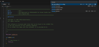

Since I upgraded to version 3.6.4 of STM32CubeIDE for Visual Studio Code, the style used for automatic code formatting has changed. For example, curly braces are now inlined, not wrapped as they were before.
How can I revert to the old style?

STM32CubeIDE for Visual Studio Code does not force any formatting features.
We promote clangd to support code indexing, enabling code navigation and enhancing the VSCode editor experience. Clangd is a utility toolbox capable of static code checking and code formatting. However, we do not provide any settings that enforce its usage but it may be used.
Please check your local VSCode setup via the command palette:
Try "Format Document With..." while a .c file is active:
You control which formatter to use.
PS: Without any third-party formatting extensions (like Prettier or others from the marketplace), VSCode defaults to the only available formatter.
