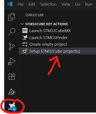

Trying to get the STM32CubeIDE for VSCode working on MacOS. I am on the latest version I think it is 3.6.4.
I installed the extension according to instructions and I made a project for my NUCLEO-446RE with CubeMx.
When I open the folder in VSCode it throws a Bad CMake Executable Error when I open the Setup STM32Cube project(s) section. In the search box in this section it also seems the NUCLEO-446RE is missing as well.

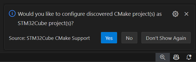

@wljr, regarding the CMake issue, if you do not have CMake installed locally, it is fully supported and expected to face an error. Let me explain what happens behind the scenes.
The STM32CubeIDE for Visual Studio Code extension pack relies on the widely used Microsoft CMake Tools extension. This extension attempts to perform a CMake configure step on any CMakeLists.txt file added to the VSCode workspace. If CMake is not available on your host, it will fail. This is outside of STMicroelectronics’ control since the extension is not ours.
Our responsibility is to notify you when a CMake project is detected, asking if you want to apply STM32Cube’s extra features. If you confirm, STM32Cube will set up the proper tools, including CMake. After setup completes, STM32Cube will trigger a CMake configure process, which should succeed.
Just in case the notification is missing, let's manually invoke the process by using the following setup action:
