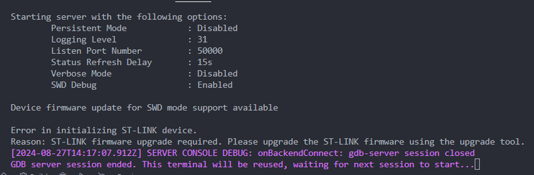

 I am using an ST-Link V2 for debugging in VS Code. It worked before, but now it gives me an error in the GDB server terminal:
"Error in initializing ST-LINK device.
Reason: ST-LINK firmware upgrade required. Please upgrade the ST-LINK firmware using the upgrade tool."

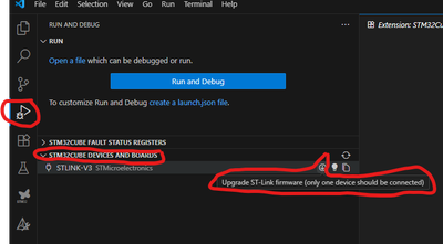

When I try to upgrade my ST-Link firmware version using the button in the VS Code STM32 extension, this error is displayed: "Error whilst trying to update STLink Firmware."
Even when the ST-Link is disconnected, this error is still displayed.I tried to upgrade it with the ST-Link utility, and it tells me the upgrade is successful, but nothing changed, and I still have these errors.

At least for me on Windows 11, the command
stlinkupgrade
typed in a Terminal worked. If the command is not found, it is essentially a .bat script in the STM32CubeCLT base directory, by default at
C:\ST\STM32CubeCLT
Naturally this does not fix the issue of the extension, which I also got on multiple machines.

The "Upgrade ST Link firmware" button in PROJECT MANAGER will ultimately run the CubeCLT's "STLinkUpgrade.bat" in this way:
let c = (0, yu.spawn)("STLinkUpgrade.bat", { env: { PATH: a } });
It's not right to use "spawn" in this way in windows, because windows needs a "shell" to run a ".bat" file.
The right way is:
   { env: { PATH: a },  shell: process.platform === 'win32' });
This sentence is in the .vscode\extensions\stmicroelectronics.stm32-vscode-extension-x.x.x\out\extensions.js file.
Or you can just typy in the stlinkupgrade directly in command line to do the upgrade, as said by @mlnslm .
