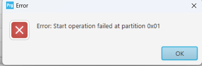

I am trying to flash the STM32MP257F-EV1 board using Programmer and now I am getting this error. Before that I followed the instructions of enable secure and ssp.
And can I renew the board
Thank

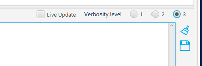

4. Change the verbosity level of the Cube Programmer to 3 and share the logs.

1. Here is the tsv I used for flashing. since i have it enabled the secure boot i signed the files that need to be signed
2. My boot pin is 0 for all
3. My STM32 Cube Programmer is the lastest vesion
4. Here is the log

First, before i enabled secure boot i could work with the board normally, using the normal package instructions. But after enabling i can't use those examples anymore and i can't flash as you can see.
Second, yes i did use SSP. So according to the feedback my board is broken and there is no way to save it, Right? And if it can be fixed, what should I do now?
Hi @Duyvnhd
If you fail to program the right keys or if you lose them, there is no way to recover from a failed secure boot (this is normal behavior).
