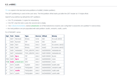

Hello STMicroelectronics Community:
 I read this wiki:https://wiki.st.com/stm32mpu/wiki/STM32CubeProgrammer_flashlayout. So I have some questions:
1.Why are the offset addresses of fsbl1 and fsbl2 boot1 and boot2 in the following example? I noticed that except for emmc, this two values of other burning methods are a specific address.
2.What is the meaning of metadatabin?

Hi @Ivy7
Title of the post is referring to problems encountered, but information seems missing (board, messages, version, etc...).
Regarding you questions:
1) Unlike other Flash, eMMC provide specific boot partitions not part of eMMC data partition, this explain why there is no offset for those. More explanation could be found in JEDEC JESD84-B51.
2) I think metadata.bin convey some TF-A parameters like the DDR settings
Regards.
