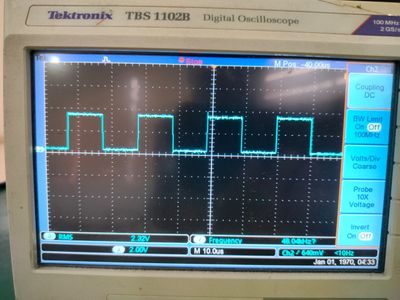

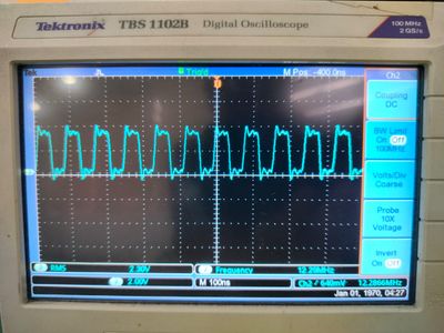

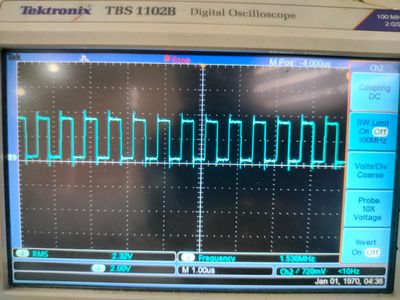

Hi @Erwan SZYMANSKI
Thanks for your reply. I'm now getting audio output from the headphone, but the sound level is very low/quiet even with all volumes set to maximum in amixer (Amplitude is low). The output sounds more like noise rather than clear audio.

bclk ( 16 bit data)bclk ( 16 bit data)mclkmclkLrclkLrclk
Mclk , lrclk,Bclk are getting properly. is there any changes in device tree ??
Hello @Midhul_Pk ,
As you confirm that you have all your clocks as expected, the remaining configuration should not rely on device tree or anything, but more on Codec configuration for me, but I am not an audio expert.
You should check the different configurable part of the codec according to the codec documentation, and see if everything is aligned to get a correct audio playback. For me, the issue does not come from your DT, all looks quite good.
