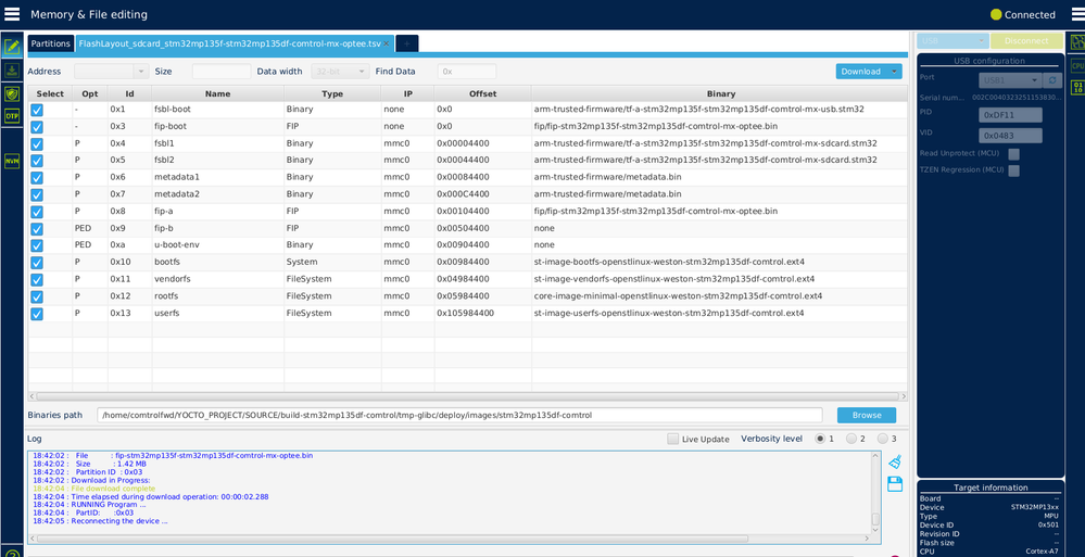

Problem:
When I try to flash using the STM32 flashing tool Using Usb, it gets stuck after the 0x03 partition.
I suspect this is due to version mismatch between CubeMX-generated files and my Yocto version.

Cube Programmer

├── st-image-userfs-openstlinux-weston-stm32mp135df-comtrol.tar.xz -> st-image-userfs-openstlinux-weston-stm32mp135df-comtrol-20251023130245.userfs.tar.xz
├── st-image-userfs-openstlinux-weston-stm32mp135df-comtrol.testdata.json -> st-image-userfs-openstlinux-weston-stm32mp135df-comtrol-20251023130245.testdata.json
├── st-image-vendorfs-openstlinux-weston-stm32mp135df-comtrol-20251023130245.testdata.json
├── st-image-vendorfs-openstlinux-weston-stm32mp135df-comtrol-20251023130245.vendorfs.ext4
├── st-image-vendorfs-openstlinux-weston-stm32mp135df-comtrol-20251023130245.vendorfs.manifest
├── st-image-vendorfs-openstlinux-weston-stm32mp135df-comtrol-20251023130245.vendorfs.tar.xz
├── st-image-vendorfs-openstlinux-weston-stm32mp135df-comtrol.ext4 -> st-image-vendorfs-openstlinux-weston-stm32mp135df-comtrol-20251023130245.vendorfs.ext4
├── st-image-vendorfs-openstlinux-weston-stm32mp135df-comtrol.manifest -> st-image-vendorfs-openstlinux-weston-stm32mp135df-comtrol-20251023130245.vendorfs.manifest
├── st-image-vendorfs-openstlinux-weston-stm32mp135df-comtrol.tar.xz -> st-image-vendorfs-openstlinux-weston-stm32mp135df-comtrol-20251023130245.vendorfs.tar.xz
├── st-image-vendorfs-openstlinux-weston-stm32mp135df-comtrol.testdata.json -> st-image-vendorfs-openstlinux-weston-stm32mp135df-comtrol-20251023130245.testdata.json
├── st-initrd-openstlinux-weston-stm32mp135df-comtrol
└── u-boot
    ├── debug
    │   └── u-boot-stm32mp13.elf
    ├── u-boot-nodtb-stm32mp13.bin
    └── u-boot-stm32mp135f-stm32mp135df-comtrol-mx.dtb
14 directories, 82 files

@Kevin HUBER @PatrickF @Erwan SZYMANSKI
1 REPLY 1
Olivier GALLIEN
Hi @Midhul_Pk
At first sight your CubeMX version seems not align with OSTL one.
Please clarify the whole ecosystem. Kirkstone is no more maintained.
Olivier
