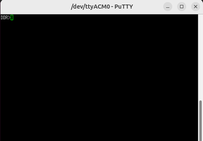

I am able to successfully use pre-build binary from this https://github.com/STMicroelectronics/STM32DDRFW-UTIL.git repo for DDR4 with stm32mp257f-evk . but the generated artifacts with stm32 header by manually compiling in stm32cubeide I am facing the issue, After flashing I am not able to enter any command in the serial monitor window.
I followed the build procedure explained in the repo's README.md
As you can see in attached image only this DDR> prompt line is printed in serial port but not accepting any input from user , when I try to enter some command it reinitialized stdin to the same DDR> prompt line.
Thank you in advance...!!
hoping for a quick reply.

maybe just a local echo issue.

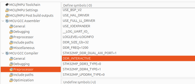

Did you have set the DDR_INTERACTIVE ?
Did you try blindly typing 'help' to see if any output ?

I have setted DDR_INTERACTIVE as per REAMME.md
If I am using serial_putchar() I can able to flush data to my promt line but If I am using printf statements i can't getting any terminal output , Its getting stuck there .
I have created my own _write() function , __io_putchar() and tried using __attribute__(( weak )) this function for multiple definitions to make my function as priority.
I am suspecting printf() is not flushing data and getting stuck there it self. Can you help on
this ?
