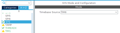

I am working with FreeRTOS on an STM32MP157CAA and configuring the CM4 core in engineering mode using CubeIDE. According to the documentation, it's necessary to select a timer other than SysTick for the HAL timebase. However, in CubeIDE, under the SYS settings in the Pinout tab, I only see SysTick available as an option.
When I generate the code, I receive the following warning:
WARNING:
When RTOS is used, it is strongly recommended to use a HAL timebase source other than the SysTick. The HAL time base source can be changed from the Pinout tab under SYS.
Despite this, I am unable to select any other timebase source besides SysTick.
Could anyone provide guidance on how to configure a different HAL timebase source for FreeRTOS in this setup? Any advice or workaround would be greatly appreciated.

just give it (select in Cube...) a timer , you anyway not need for your program, i took TIM6 :
Then it uses this and adjust it...you dont need to care about it.

Thank you for your response. I understand what you mean. As I mentioned, I am unable to select any other timer; only SysTick is available as an option. Unlike in your case, I do not see any other timers like TIM6 highlighted for selection.
Do I need to configure anything else to enable the other timers, or is there another step I am missing to make these timers available for selection? Any guidance would be greatly appreciated.
Please have a look on the attached picture.
Hmmm...
1. you can only select timers, that are not used (by you), state : grey, unused on left side.
2. timers (in clock tree need a clock...) check in clock tree, you have clocks everywhere:

Possibly because @AScha.3 was looking at the MCU version of CubeMX, but you're using the MPU version?
I've moved the thread from the MCU forum to the MPU forum now.
