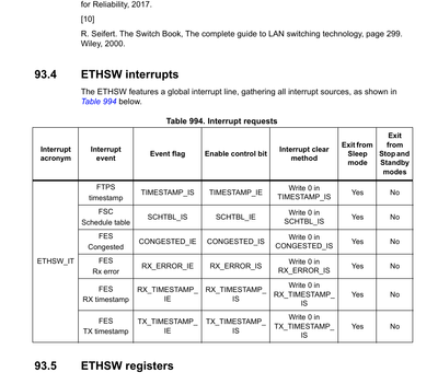

The SERC ID 36 corresponds to USART6 (see "Table 994. SERF resources mapping" in the reference manual)

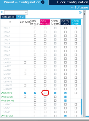

Hi @Christophe Guibout
So in order to have access to usart6 as console output e.g in tf-a, u-boot and linux kernel, the op-tee must be configured for usart6?
I have tried to enable usart6 onto tf-a as early boot, without success!
By the way!
One cannot enable usart6 at CubeMX and the table 994 inside the reference manual does not point at "SERF resource mapping". I'm guessing you mean "SERC resource mapping". Table 994 is "Interupt requests".
STM32MP23/25xx advanced Arm<Sup>®</Sup>-based 32/64-bit MPUs - Reference manual
It seems like a explanation why it's so difficult to get usart6 working.
