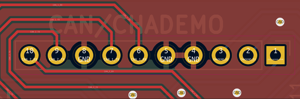

Note: My reference to can0 and can1 is from using SocketCAN. On the board schematics the two can interfaces are called can1 and can2 respectively. Just wanted to clarify.
I have attached the screenshot of the can1 and can2 pins below:
Do I need to use a CAN transceiver in Approach Three between the two CAN nodes to be able to talk to each other?
So far I have tested all of the above three approaches and none are working.
Looking for someone to help to develop a can bus test which exercises the real PINS (Rx & Tx) on the bus.

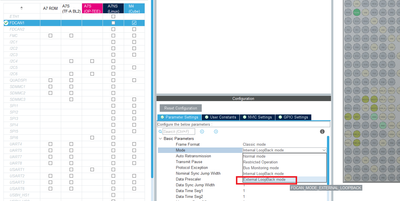

I'm not STM32MP1 expert but it seems if you need to work with FDCAN on A7 side you need to do it with Linux drivers and not with HAL like the case of CM4:
So you need to configure the FDCAN on Linux. You need to find something in the Linux driver that let you configure your instance in external loopback mode.

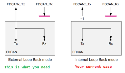

The loopback mode has to flavors: Internal and External modes.
So for that you need to configure your FDCAN peripheral in External loopback mode:
To communicate between to nodes in Normal mode you need a transceiver for each node.

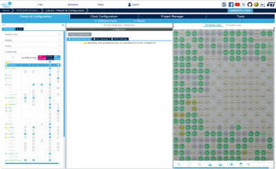

Hi @mƎALLEm thanks for your reply. I just checked my ioc file in CubeMx and it looks like the FDCAN1 and FDCAN2 both are connected to A7 rather than M4. Please see below:
And also I noticed in my case under Parameter Settings, it says "this peripheral has no parameters to be configured". I am wondering how can I add the required parameters here? Please let me know if I have missed to add any information. Many thanks in advance.
