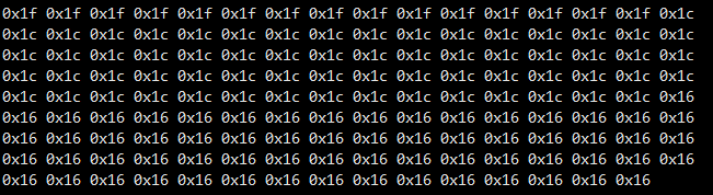

CM4:基于官方给出的例�?,我去掉通过IO�?�数�?�采样​,采用填充固定数�?�进入缓冲区的方法,在传递到DDR的相应缓冲区中。
A7:基于官方的测试例�?,�?写入文件,直接将接收到的数�?�显示到频幕上。​
我�?�现,在多次数�?�传输�?�,Linux应用程�?读�?�​的DDR数�?�出现错误,这些数�?�以64字节为�?��?。
如下图所示,我填充的时0x1f,但是缓冲区中出现了0x1c和0x16,他们都是之�?写入的数�?�。​
请问这个问题�?�能是怎样造�?的。​

could you please tell me the data rate you are using ?
On the example, the maximum data rate, due to packing algorithm on M4, was 8MHz.
In your case, I guess that the data rate can be much higher, but this information is very important to reproduce the issue.

I send data very slow ,about 1024 bytes per 1s.
but in my test stm32_rpmsg_sdb program, I get 4096 buffer.
SDB means Shared Data Buffer; and the goal is to exchange high data volume thanks to big buffers.
In our example, M4 fills a buffer of 1MB, and then the driver transfers this 1MB buffer.
At the maximum rate, 8MHz sampling, with a packing of 8, it means we have one transfer of 1MB per second.
In your case, it would take 1000 seconds to have one transfer.
So, I don't understand your configuration.
Would it be possible please to share your M4 code?
I change your code, M4 sample adc and send data 2K bytes/s.If i use rpmsg_tty, i can finish it,but linux program is very busy. It is not a good idea. so i want usb rpmsg_sdb.

​I checked your code and I saw at leat one isse:
you modified the size of the buffers:
#define SAMP_DDR_BUFFER_SIZE (1024)
instead of 1024*1024
Then, this is not in line with the sdb driver, which manages buffers of 1MB
In your use case, you have a low data rate exchange betwwen A7 (Linux) and M4, and you don't need sdb to do this.
I would advice to exchange data over virtual UART, instaed of SDB.
Please have a look into M4 examples : OpenAMP_TTY_echo
