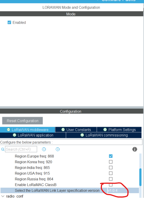

I am having the same compiler error:
LoRaMac.c:1650:40: error: 'McpsIndication_t' {aka 'struct sMcpsIndication'} has no member named 'ResponseTimeout'
while using STM32CubeIDE V1.17.0 and the STM32CubeWL V1.3.1.
Should I use the Cube IDE v1.18.0 ? How to fix this ?
‎2025-05-15 7:03 AM
Ok, found the issue. The Lora link layers version must be v1.0.4 and not v1.0.3
