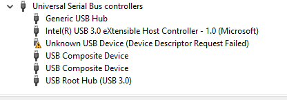

However if I apply the same logic in BLE_p2pClient (\STM32Cube_FW_WB_V1.12.0\Projects\P-NUCLEO-WB55.Nucleo\Applications\BLE\BLE_p2pClient) I got USD Device not recognised notification from Windows 10.
For testing I`m calling Bootloader_Init() before HAL_Int() in main.c just to see if any project specific configuration is causing an issue but nothinc changed. Still USB not detected.

This is the screenshot from Device Manager. Unknown USB device is the STM32 as you might guess.

Hello @TGUCL.1​ ,
Thanks for your feedback,
This issue is similar to the one described in this thread, it is acctually an expected behavior because RNG and USB share the same clock source, please check AN5289, "Figure 9. Algorithm to use USB on CPU1" and the description below it for further details.
The solution is provided in the mentioned thread can help you solve the issue.
You can also use the solution provided under STM32Cube_FW_WB_V1.12.0\Projects\P-NUCLEO WB55.USBDongle\Applications\BLE\BLE_p2pServer.
You just need to place the "PeriphUsbClock_Config" function under the "USER CODE BEGIN 4" in main.c, and call it from the "USER CODE BEGIN SysInit".
PS: Check the CFG_USB_INTERFACE_ENABLE flag in app_conf.h file and make sure that is set to 1.
I hope this helps !
