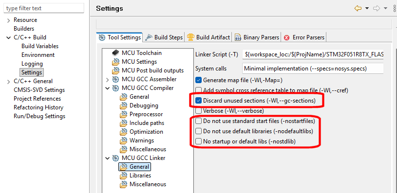

I found a difference in the optimization level: in the STM32CubeIDE project it's set to -Os, while in the CMake project it's -O0. However, after switching to -Os the flash overflow is now 100.2%. Maybe there's something else? What else can I check?
So what was the flash use percentage in the CubeIDE build ?
Have you done a thorough check of all the other settings; eg,
Do you get a map file from the CMake build?
Note that the full command line appears in the Console when you do the CubeIDE build.
Other compilation flags are exactly the same; I can't find any differences.
CubeIDE reports 100% RAM usage and 99.35% flash usage, so it's very close to the memory limit. Comparing the map files, it seems that more code is being included in many sections.
But I don’t understand why, the project and the libraries should be the same. Why does it change when using the CMake toolchain?
Have you enabled ASSERTs, or some other debug/diagnostic/logging feature?
