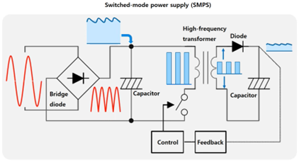

I found that the STM32WB55 microcontroller have SMPS but I cannot understand how much external component is required.
Here is basic SMPS circut and could you tell me how much circuit is in the microcontrollers SMPS?

For external component, please look part 1.1.3 External components of AN5246 and figure 5 of DS11929.
You can't directly apply AC current to the microcontroller's SMPS to get DC current.
VDDSMPS is connected VDD and VFBSMPS is connected to C et l like on figure 5.

In addition, can I directly apply AC current to the microcontroller's SMPS to get DC current?

I read AN5246 but still I'm not sure whether I can use random AC signal as a power supply to the STM32WB microcontroller.
if it is possible, Should I connect AC+ to the VDDSMPS and AC- to the VFBSMPS?

Regret to hear this. if the microcontroller has an internal AC-DC converter, I would not need any extra IC components anymore. Sad.
