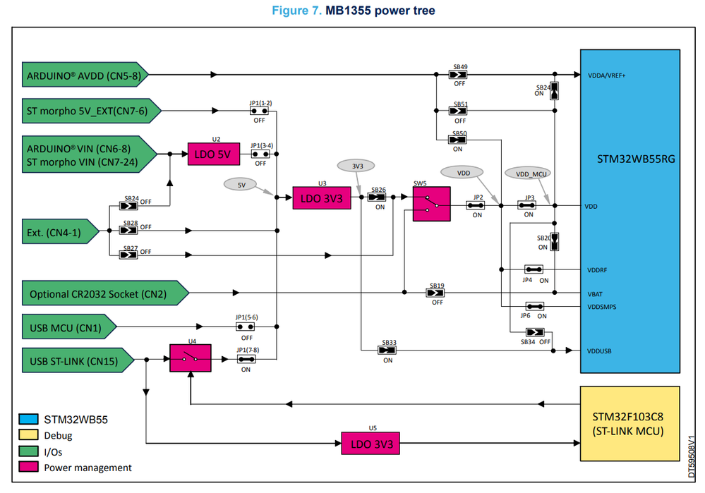

Take a look at the schematics - see if there is a suitable regulator ...
As always, the schematics will be available on the 'CAD Resources' tab of the Product Page:

See also the Power Tree diagram in the User Manual:
https://www.st.com/resource/en/user_manual/um2819-stm32wb-nucleo64-board-mb1355-stmicroelectronics.pdf#page=12
via: https://www.st.com/en/evaluation-tools/nucleo-wb55rg.html#documentation
From that, you'd need to be looking at the specs for U3 ...

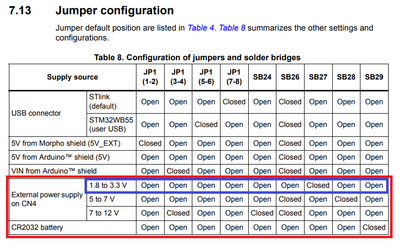

Looking at the power tree diagram you provided (which oddly I cant find in my copy of the User Manual), I would need to close SB28, remove all the jumpers from J1 & make sure SW5 was in the right position?
I can find SB28 but I cant find CN4 or SW5 on my board.

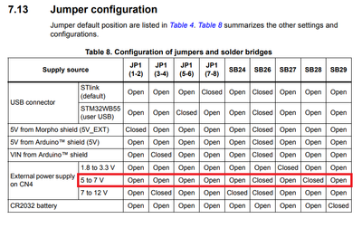

I did find the jumper & SB configuration table though (see below), which implies that I need to close SB27 and keep SB28 open? Still no clue where CN4 is though...<<< OK found it now
NO ! You not on 3.3V supply !
You want use a LiPo as source, so it has 3.0 ... 4.2V .
You have to use the 5..7V INPUT setting, SB28 closed.
So the above selection then, that is not clear in the docs at all.
Right. 5..7V range
