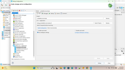

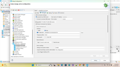

I am trying to debug code for Nucleo-WL55JC1 board using sample code from the STM website.  It is the LoRAWAN_End _Node.  I complies fine and creates .elf file.  However when a try do download with the STM32Cube I get the following error:
An internal error occurred during: "Launching LoRaWAN_End_Node".
'com.st.stm32cube.ide.mcu.toolchain.IToolChainInfoProvider[] com.st.stm32cube.ide.mcu.toolchain.ToolChainHelper.getToolChainInfoProviders()'
Thanks for the help.

The procedure is as follows:
- Clean
- Build
- Debug as a C/C++ Application
