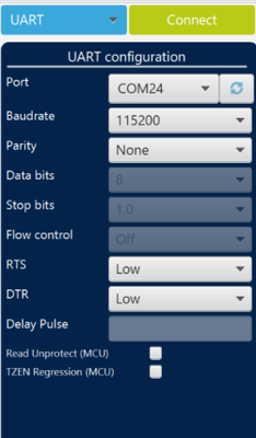

  4. Set the boot mood to UART, the parity to None, the baudrate to 115200 and the correct COM port: STTwo32_4-1757065342494.png
  5. Click on the Connect button (you may need to click on the reset button).
  6. After connection established, click on the Mass erase button:

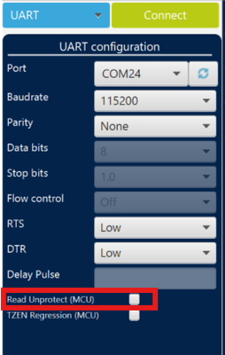

  7. (optional) If that didn't work, check the read unprotected option before step 5 and click on the Connect button that should perform a Mass erase:

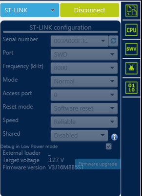

Please note that before erasing, one must return to ST-LINK PORT: SWD
