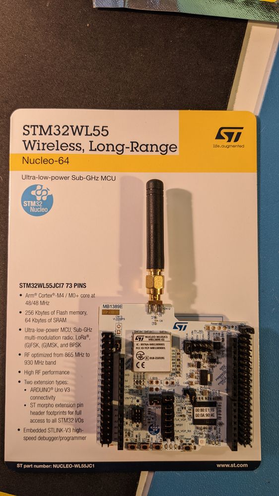

I recently purchased a STM32WL55JC17 and I could not get it to connect to the STM32CubeIDE. I thought I would try to update the ST-LINK and that started to work but failed near the end. I fear I may have corrupted it. Help!

0693W00000Nt3scQAB.jpgI understand that the firmware version is strange and that is probably why the ST-Link utility won't upgrade the board because it doesn't understand it either. Is there a way around that?
This is an official Nucleo-64 board I purchased from Mouser a week ago, see pic above. When you say "Try with a real STLink." do you mean use another ST-Link to program the STM32WL55 microcontroller or use another ST-Link to update the firmware on the onboard STLINK-V3E MCU? Because I would like this to work as it was manufactured by ST. I would like to fix the STLINK-V3E MCU. Is there a way to upload the appropriate firmware any other way?
