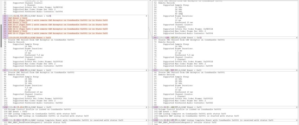

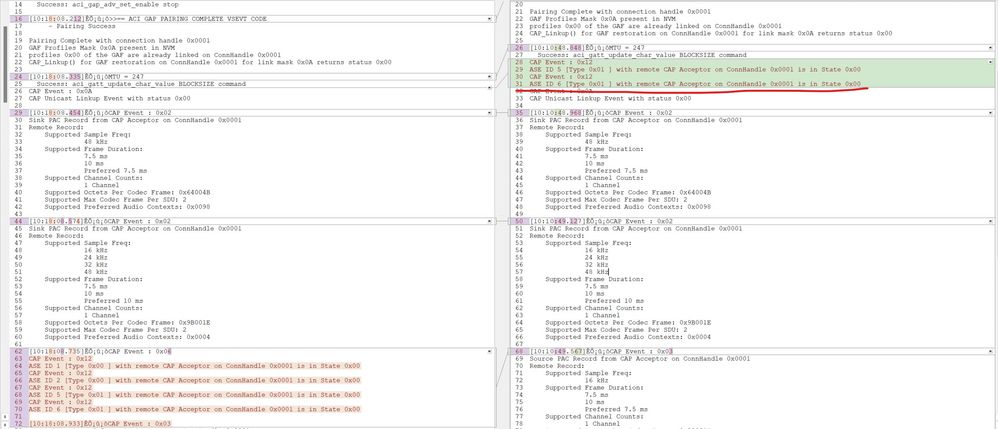

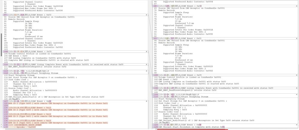

I was using a HAP central, from example BLE_Audio_HAP_Central, to connect to a headset. I can connect and start telephone stream successfully at the beginning. But after some times later, some hours perhaps, the connect and CAP linkup are returns OK, the steam cannot be started. The log shows that CAP_Unicast_AudioStart() returns OK, but no process was proceed and the procedure complete event will be triggered 5s later with error status 0x91. what's more, remove the bonded data by aci_gap_remove_bonded_device() and repairing still could not fix this issue. I have to clear all bonding table by aci_gap_clear_security_db() and repairing, then I can linkup and start stream successfully.
Compare the failed process with the successful one, in linkup process the CAP event 0x12 was incomplete , ASE ID 1, 2 are missing, or even no CAP event 0x12

[10:18:08.735]ÊÕ¡û¡ôCAP Event : 0x06
CAP Event : 0x12
ASE ID 1 [Type 0x00 ] with remote CAP Acceptor on ConnHandle 0x0001 is in State 0x00
CAP Event : 0x12
ASE ID 2 [Type 0x00 ] with remote CAP Acceptor on ConnHandle 0x0001 is in State 0x00
CAP Event : 0x12
ASE ID 5 [Type 0x01 ] with remote CAP Acceptor on ConnHandle 0x0001 is in State 0x00
CAP Event : 0x12
ASE ID 6 [Type 0x01 ] with remote CAP Acceptor on ConnHandle 0x0001 is in State 0x00

[10:18:11.213]ÊÕ¡û¡ôHAP Linkup Complete Event with ConnHandle 0x0001 is received with status 0x00
HAP_HARC_ReadPresetsRequest() returns status 0x92
[10:18:14.374]·¢¡ú¡ó{A\0vµ\0ÿÿ}¡õ
[10:18:14.378]ÊÕ¡û¡ôStart Telephony Stream
Set Start Stream for CAP Acceptor 0 on connHandle 0x0001 :
Sink Codec Conf :
    Audio Channel Allocation : 0x00000003
    Channel Per CIS : 1
    Sampling Freq : 0x03
Source Codec Conf :
    Channel Per CIS : 1
CAP_Unicast_AudioStart() of 1 CAP Accceptors in Set Type 0x00 returns status 0x00
{A\0wµÄT}
[10:18:14.532]ÊÕ¡û¡ôCAP Event : 0x12
ASE ID 1 [Type 0x00 ] with remote CAP Acceptor on ConnHandle 0x0001 is in State 0x01
[10:18:14.692]ÊÕ¡û¡ôCAP Event : 0x12
ASE ID 2 [Type 0x00 ] with remote CAP Acceptor on ConnHandle 0x0001 is in State 0x01
[10:18:14.853]ÊÕ¡û¡ôCAP Event : 0x12
ASE ID 5 [Type 0x01 ] with remote CAP Acceptor on ConnHandle 0x0001 is in State 0x01
[10:18:14.972]ÊÕ¡û¡ôCAP Event : 0x12
ASE ID 6 [Type 0x01 ] with remote CAP Acceptor on ConnHandle 0x0001 is in State 0x01

 log for stream start fail
[10:10:48.442]·¢¡ú¡ó{A\0v³\0ÿÿ}¡õ
[10:10:48.445]ÊÕ¡û¡ôaci_gap_terminate_gap_proc() returns status 0x00
HAPAPP_StopScanning() returns status 0x00
Selected device 0
aci_gap_create_connection() returns status 0x00
{A\0w³\0V˜}P_PROC_COMPLETE_VSEVT_CODE
>>== ACI_GAP_PROC_COMPLETE_VSEVT_CODE
>>== HCI_LE_ENHANCED_CONNECTION_COMPLETE_SUBEVT_CODE - Connection handle: 0x0001
     - Connection established with @:a4:90:ce:1e:a9:87
     - Connection Interval:   40.00 ms
     - Connection latency:    0
     - Supervision Timeout:   10000 ms
>>== device is already bonded
aci_gap_send_pairing_req returns 0
  Success: aci_gap_adv_set_enable stop
[10:10:48.726]ÊÕ¡û¡ô>>== ACI_GAP_PAIRING_COMPLETE_VSEVT_CODE
     - Pairing Success
Pairing Complete with connection handle 0x0001
GAF Profiles Mask 0x0A present in NVM
profiles 0x00 of the GAF are already linked on ConnHandle 0x0001
CAP_Linkup() for GAF restoration on ConnHandle 0x0001 for link mask 0x0A returns status 0x00
[10:10:48.848]ÊÕ¡û¡ôMTU = 247
  Success: aci_gatt_update_char_value BLOCKSIZE command
CAP Event : 0x12
CAP Event : 0x12
CAP Event : 0x0A
CAP Unicast Linkup Event with status 0x00
[10:10:48.968]ÊÕ¡û¡ôCAP Event : 0x02
Sink PAC Record from CAP Acceptor on ConnHandle 0x0001
Remote Record:
    Supported Sample Freq:
              48 kHz
    Supported Frame Duration:
              7.5 ms
              10 ms
              Preferred 7.5 ms
    Supported Channel Counts:
              1 Channel
    Supported Octets Per Codec Frame: 0x64004B
    Supported Max Codec Frame Per SDU: 2
    Supported Preferred Audio Contexts: 0x0098
[10:10:49.127]ÊÕ¡û¡ôCAP Event : 0x02
Remote Record:
              16 kHz
              24 kHz
              32 kHz
              48 kHz
              7.5 ms
              10 ms
              Preferred 10 ms
              1 Channel
    Supported Octets Per Codec Frame: 0x9B001E
    Supported Preferred Audio Contexts: 0x0004
[10:10:49.567]ÊÕ¡û¡ôCAP Event : 0x03
Source PAC Record from CAP Acceptor on ConnHandle 0x0001
Remote Record:
              16 kHz
              7.5 ms
              10 ms
              Preferred 7.5 ms
              1 Channel
    Supported Octets Per Codec Frame: 0x28001E
[10:10:49.727]ÊÕ¡û¡ôCAP Event : 0x03
Remote Record:
              16 kHz
              24 kHz
              32 kHz
              7.5 ms
              10 ms
              Preferred 10 ms
              1 Channel
    Supported Octets Per Codec Frame: 0x500028
    Supported Preferred Audio Contexts: 0x00D2
[10:10:50.446]ÊÕ¡û¡ôCAP Event : 0x39
Volume Control Profile is linked on ConnHandle 0x0001
CAP Event : 0x00
CAP Linkup Complete on Connhandle 0x0001 with status 0x00
Complete HAP Linkup on ConnHandle 0x0001 is started with status 0x00
[10:10:52.127]ÊÕ¡û¡ôHAP Linkup Complete Event with ConnHandle 0x0001 is received with status 0x00
[10:10:54.362]·¢¡ú¡ó{A\0vµ\0ÿÿ}¡õ
[10:10:54.366]ÊÕ¡û¡ôStart Telephony Stream
Sink Codec Conf :
    Channel Per CIS : 1
Source Codec Conf :
    Channel Per CIS : 1
{A\0wµÄT}
[10:10:59.485]ÊÕ¡û¡ôCAP Event : 0x0B
CAP Unicast Start Procedure is Complete with status 0x91
