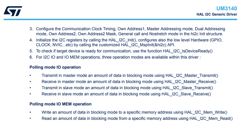

I’m using an STM32WBA65 and trying to communicate with a peripheral (PTX30W) over I2C1.
The peripheral requires the following I²C sequence:
STARTWRITE → REPEATED STARTREAD → STOP
However, using HAL_I2C_Master_Transmit() followed by HAL_I2C_Master_Receive() does not work, because both HAL functions generate a STOP condition, and the PTX30W does not accept a STOP between the write and read phases.
On STM32WBA, I don’t see a HAL equivalent of HAL_I2C_Master_TransmitReceive() that would allow a repeated START without a STOP in between.
My questions are:
  • Is there a way to achieve a WRITE + REPEATED START + READ sequence using the HAL on STM32WBA?
  • Or is the correct approach to switch to the LL (Low Layer) I2C driver to get finer control over START/STOP conditions?
Any guidance or best practices for this use case would be appreciated.

There are HAL_I2C_Master_Seq_Transmit_(IT/DMA) and HAL_I2C_Master_Seq_Receive_(IT/DMA) functions that could be used here. No blocking ones.

Use HAL_I2C_Mem_Read to write 1-2 bytes, then read a bunch, using a repeated start.
@Emil Damkjaer PETERSEN @Loic CHOSSAT this is particularly poorly described in the HAL documentation:
https://www.st.com/resource/en/user_manual/um3140-description-of-stm32wba-hal-and-lowlayer-drivers-stmicroelectronics.pdf#page=327
I really don't think it's at all clear from this description that "MEM" is the one to use in this application?
Please can we have a clear description like @TDK's in the HAL manuals - this kind of question comes up frequently on the forum!
I suspect that most applications where HAL_I2C_Mem_Read is the correct choice are not actually "memory" devices - as is the case here.

Thanks for your answer, but before reading i have to send 4 bytes and mem_read can only accept size of 8bits or 16 bits :
in HAL_I2C_Mem_Read() :
assert_param(IS_I2C_MEMADD_SIZE(MemAddSize));
So, it's not usable here.
And i already tried to make it work with the stop between writing and reading but it's not working.
I guess i will have to use lower level library.

There is - that's what HAL_I2C_MEM_Read does.
But, as you say, the read part is limited.
And, as I said, the description does not give any clue as to what it actually does.
You could start by looking at the source of HAL_I2C_MEM_Read - see if that can be easily adapted ...
