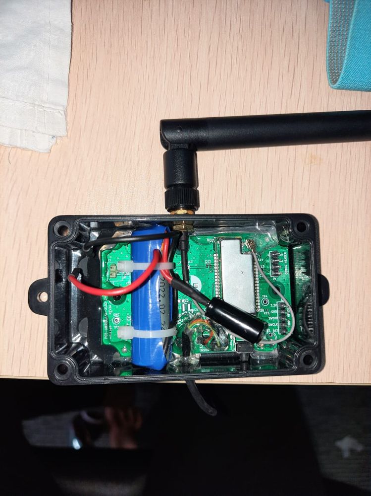

PPraj.1
PPraj.1Author
July 19, 2022
0693W00000QLUBAQA5.jpg@Andrew Neil​
I am using the STM32CubeWL Firmware Package v1.0.0 ( release date 28th Oct 2022)
This consist the 3rd Party LoraWan Middleware package as per below
LoRaWANV4.4.4BSD-3-Clause
V2.2.1ST release notes
For Network , yes we have full control on this.
For Device, We may check the Dev-Kit if available internally. Just to clarify we are just checking ST module manufactured by us with WL chip, there are no other peripheral or customizations. as you can see above.
Hope that answers your query.

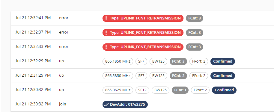

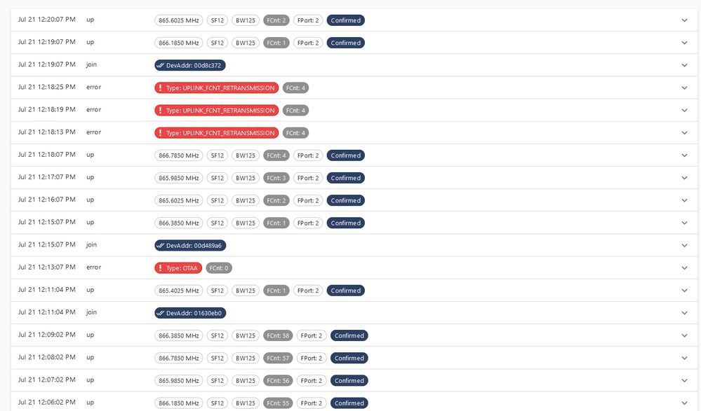

PPraj.1Author
July 21, 2022
Hello @Louis AUDOLY​
  1. According to you I have tried LoRaWan_End_Node example
  2. When I used ADR then i faced framocunt error
  3. When I not used ADR but default data rate then i faces again that error.
So you can explain there is network problem or not?
Also answer Why network Problem ? Give me specific reason for that.
I have added some photos of FrameCount error you can see(both with ADR and without ADR)0693W00000QLiy6QAD.png0693W00000QLixmQAD.png
