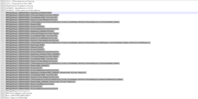

    • Delete all references to "MMTAppReg" (from line 57 to line 90 on your attached .ioc file) STTwo32_1-1758270714628.png

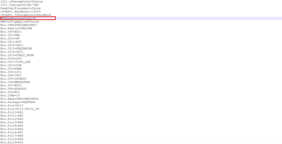

  • Modify "MMTAppRegionsCount=4" to "MMTAppRegionsCount=0" (line 91 of your attached .ioc file)STTwo32_2-1758270886910.png
