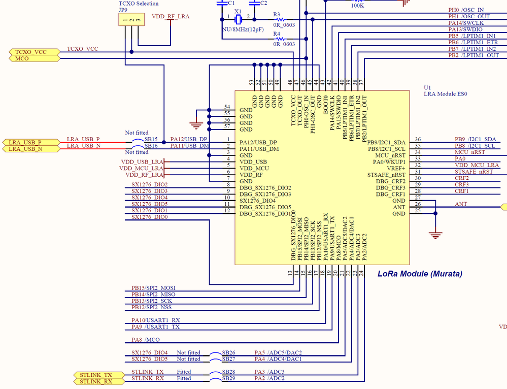

B-L072-LRWAN1: Why is the TCXO powered from PA12?
Andrew Neil
ie, what drove the choice of PA12, specifically ?
Using PA12 means that you have to power-up the VDD_USB domain - which, I think, adds some extra current consumption. See:
https://community.st.com/s/question/0D53W00001Fncm7SAB/stm32l072-vddusb-supply-current-for-pa11-pa12
So why do that?
Literally all of the pins on that chip are used. Something needs to go there, where else would you put it? A lot of the other potential pins are peripheral-specific and would suffer the same drawback. Probably not a specific choice but rather an artifact of what pins were left over after everything else was routed.

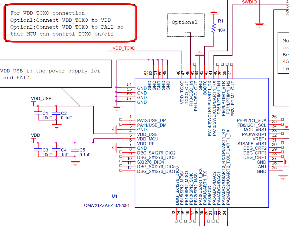

However, Murata have it in their "reference circuit" - where the majority of connections are uncommitted:
but maybe their reasoning was the same?
Hmm, it could be. Or perhaps they just copied what ST did without thinking? Or maybe to have it be driven from a voltage other than VDD? Can't think of any other reason to have it like that.
