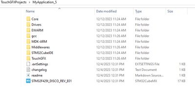

When creating a TouchGFX project with the STM32F429I-DISC1 board, I get the following:
Adding a button and generating the code yields the following project docs:
Opening the generated cproject file imports the following project:
Notice that the IOC(MX) file has a different naming convention. The project seems to be the a older board revision.

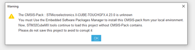

Note: I have seen and tried some online tutorials for adding the IOC file into the project, but this leaves the user needing to set up the .IOC file and I get the following message:
Not to mention several build errors.

I will start talking about the first approach which is the easiest one (Creating project through TouchGFX). TouchGFX board projects are made to make the creation of a GUI as simple as possible, so, all the configurations related to the board and the MCU are already done. This is not the case when you create a project through STM32CubeMX.
I can see that CubeMX has failed to download the X-CUBE-TOUCHGFX 4.23.0, please follow the instruction on this post to install it : https://community.st.com/t5/stm32-mcus-touch-gfx-and-gui/x-cube-touchgfx-4-23-0-is-out/td-p/616481
For creating a project, I suggest you to start your project from the TouchGFX Designer by choosing the board you are working on. Then, design your application and generate code. After that, navigate through the STM32CubeIDE and open the .cproject file. In the IDE, implement you logic behavior (code, functions,..) under Includes -> gui/Include -> gui -> "YourScreen" -> "YourScreen".hpp and Application -> User -> gui -> "YourScreen".cpp

Thank for the response. It was quite helpful. I have updated to X-CUBE-TOUCHGFX 4.23.0. Moving forward with the dev kit, I will definitely heed your advice on workflow. In your screenshot, I noticed your project does not include the .IOC or MX file from the project directory. How would you go about importing that into the project?
