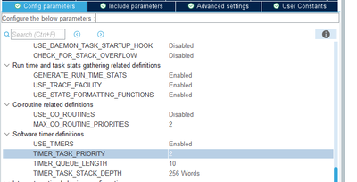

https://freertos.org/Documentation/02-Kernel/02-Kernel-features/05-Software-timers/03-Timer-daemon-configuration
See documentation of FreeRTOS software timers. The parameter in the ioc.-File is shown in the screenshot:
Increasing this parameter to a higher value than osPriorityNormal should work.
Give it a try and get back to me if it works.
Afterwards i would suggest rewriting your
void threadEntryPoint() {function. The problem is that this function blocks for up to 50 milliseconds each time HAL_UART_Receive is called. Instead use a lower timeout and instead check once per millisecond if something arrived, maybe something like the following (used autotranslate for comments):

2025-11-27 2:22 AM
I use Software timer (Freertos), PREEMPTION is Enabled.
I don't know the Timer priority: is there a parameter to set it ?
2025-11-27 2:44 AM - edited 2025-11-27 2:52 AM

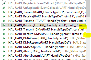

2025-11-27 5:11 AM
The slave that send me data is a BarCode Reader.
I don't know the size of bar code scanned, so I have to develop a driver that can receive an asyncronous packet of unknow length.
I see INT,DMA mode but it requires size
