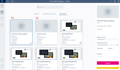

Perhaps someone can help me with regard to creating a TBS please.
I created a TBS following the instructions here https://support.touchgfx.com/docs/development/scenarios/scenarios-create-at
I'm using TouchGFX V 4.26.0 so I altered the instructions given for V.4.25.0 accordingly.
Apart from some confusion over the naming of the JSON file which always reverts to 'MyApplication' following the pack command, the TBS that I created worked.
I then went on to create a second TBS for a different set up. However this one didn't work, and the first TBS that I had created stopped working. (I must add at this stage that I don't recall changing anything that related to the first TBS when I created the second but I honestly can't be sure).
The error I get is 'Download of 'MyAppicationName' failed, this is shown highlighted in the screenshot below at the bottom right. My two TBS's are highlighted with red star. The first TBS I created is named '4-inch-Circular', and the second 3.45 inch starter project.
I think when I created and tested the first TBS, the download icon (down arrow in the bottom right of the TBS icon in the snip) showed as 'available offline', but I can't be sure of this.
.... So that raises the question, where is the TBS expected to be downloaded from as surely its' stored locally in the .tpa file that I created and placed in location C:\TouchGFX\4.26.0\app\packages ?

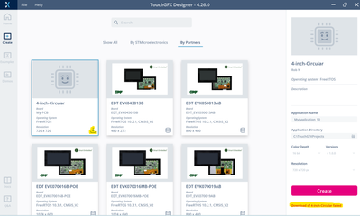

An update on this issue. I re-created my first project TBS which now works.
The second project also works but it generates a JSON file that is literally named 'MyApplication'. It also correctly generates a .zip file that has the correct project name, this file is very large (41,216 KB, I did clean the project as described in the documentation)
The 'MyApplication.json' file contains metadata for a URL which contains the name 'MyApplication'
Looking at other TBS json files, this should be the project name.

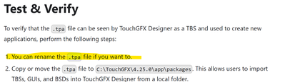

I went on to change the name of the .tpa file (as the documentation says you can). After doing so the TBS failed to work, previously the TBS showed as being available offline but now shows that it is available for download and gives a Download error when the Create button is pressed.
I now believe this explains my original issue.

  2. If the .tpa is renamed then the TouchGFX 'create' seems to look elsewhere for the tpa and tries to download it, resulting in a download error.
