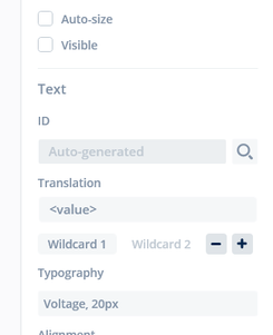

I've got a text box configured with a wildcard:
In Designer, I've got a typography set to Voltage, 20px:

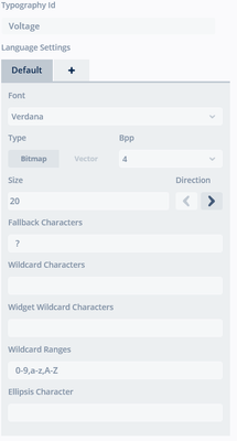

Here's the typographies:

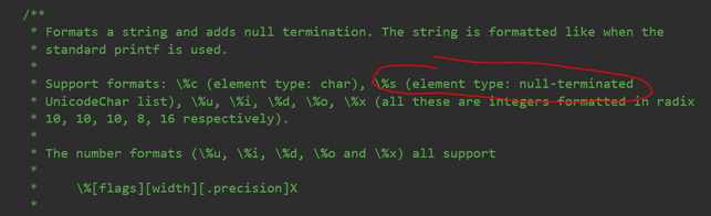

Try to add 'u' prefix to the string as printf expects unicode
Unicode::snprintf(textCellVoltageBuffer, 20, "%s", u"123");
touchgfx\framework\include\touchgfx\Unicode.hpp

Yes, that works!  Thanks.
