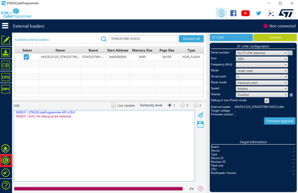

I am trying to get the demos to work on the disco board, but every time I upload the code the ST logo appears and then it hangs.
I upload the hex files via STM32CUBEPROGRAMMER where it successfully uploads but always fails to verify giving me this error "Error: Data mismatch found at address 0x90000000 (byte = 0x00 instead of 0x99)".
I am using the hex file v1.0 found here: https://www.st.com/en/evaluation-tools/32f769idiscovery.html#documentation. I have also tried 1.16.0, 1.15.0, and 1.14.0 of the STM32Cube MCU Package for STM32F7 series. Every time I try to build the example for TouchGFX, there are errors.

‎2022-01-12 9:17 AM
Hi @JTurn.2​
I wonder if you selected the adequate External Loader for your board ?
Houda
‎2022-01-16 3:29 AM
Hi Houda,
I have already selected the adequate External Loader and the result is the same.
JTurn.2
