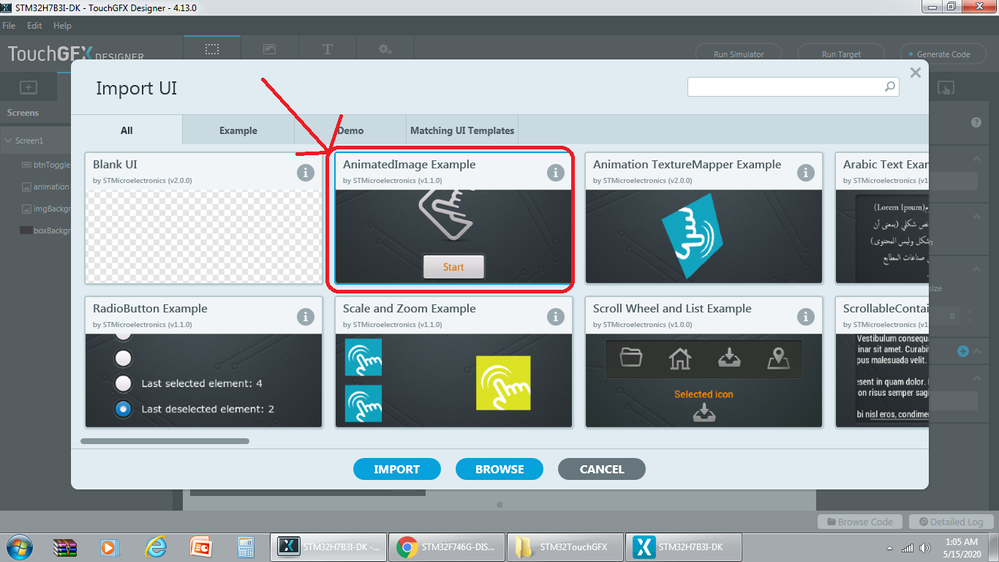

Karan 123
Senior
AD�?b (Community Member)
Apart from that, you can able look at pre-build demo in TouchGFX
Hope the helps.
karan
touchgfx/widgets
