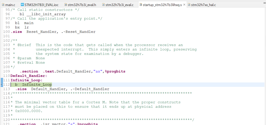

I am using the STM32H7B3I-EVAL evaluation board with a code generated by TouchGFX 4.20.0. My goal is as follows:

When I run this, the display seems to work and I get no errors. However, when I click the wakeup button, the display freezes and I enter the default handler. I have set the wakeup button to the lowest priority on the interrupt (15). Does anyone know what would cause this?

KnarfB
Principal III
If an IRQ handler is not defined in the code, a default implementation is used in the interrupt vector table, the DefaultHandler. So it looks like the original IRQ handler for your button is not present.
Compare your project to the STM32Cube_FW_H7_V1.10.0\Projects\STM32H7B3I-EVAL\Examples\BSP example which comes with the firmware package.
hth
KnarfB
Hello KnarfB,
Thank you for the reponse! Yes, I did put a breakpoint in my BSP_PB_Callback and noticed it is never entered. So that confirms that.

Hello Piranha,
Interesting, I thought the EXTI15_10_IRQHandler initialization would be handled in the BSP_Init, but I see I was mistaken.
I added this line and my code worked.
Thank you very much! ^.^
It is an actual interrupt handler. Everything else is just layers of abstraction and callbacks called from there. :)
That is good to know! Thank you :)
